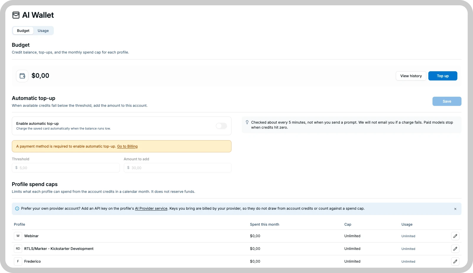

The Budget tab of the AI Wallet in the TagoIO Admin: the credit balance with View history and Top up, the automatic top-up threshold and amount, and a monthly spend cap for each profile.

The wallet shows how credits entered and left the account. At a glance you can read the current balance, how many purchases still hold unspent credits, and the date the next batch expires, and every purchase, spending debit, expiration, and support adjustment lands in the history. You can trace AI spend without exporting anything or stitching together invoices.
What happens when AI Credits run low?
Top up manually from the wallet, or switch on automatic top-up so the balance refills on its own. Each purchase runs from 10.00 to 1000.00 in your wallet currency, charged to the default card on your account. A service fee is added to the card charge rather than to your balance, and the Admin shows the current rate before you confirm.
For automatic top-up, you set a threshold and an amount. When the balance drops below the threshold, TagoIO schedules a purchase for the amount you chose. A background check runs every few minutes, so a top-up lands shortly after the balance dips, not at the exact moment of the request that crossed the line. A request that arrives before the top-up lands can still fail for insufficient credits, so leave some headroom in the threshold. Keep a valid card on the account so top-ups go through: a failed charge leaves the balance where it is, and TagoIO does not email you about it.

Set an optional monthly spend cap on each profile. Without one, a profile shows Unlimited and can spend the whole account balance. The cap limits how much one profile can spend in a calendar month, counted in UTC, and it resets at the start of each month. When a profile reaches its cap, its requests to paid models are refused until the month rolls over or you raise the cap. Caps do not carve out part of the balance: every profile still draws from the same account balance.
